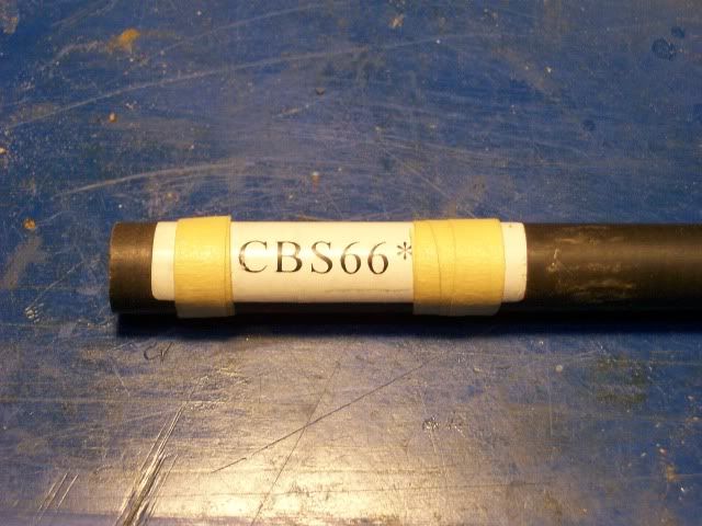

Here we have the blank.

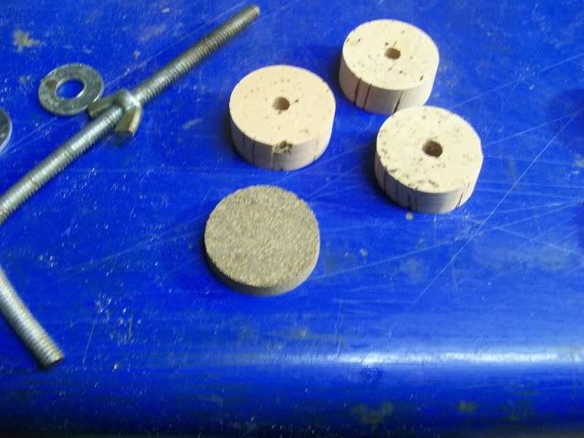

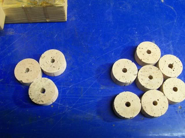

This is a selection of cork rings that we have to build the grips. The rear butt will be 1 1/2"-1 3/4" and the grip will be 3 1/2"

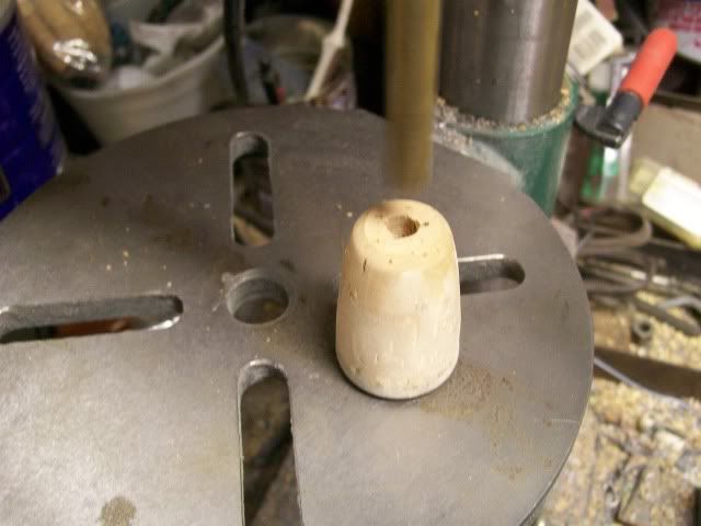

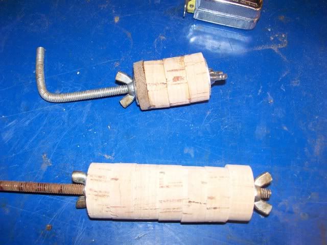

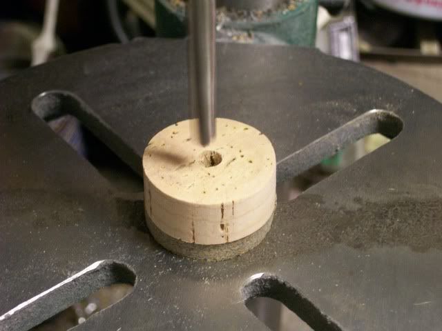

Here is the making of a rubberized cap on the butt cork. It's without a hole, so we will be drilling it out.

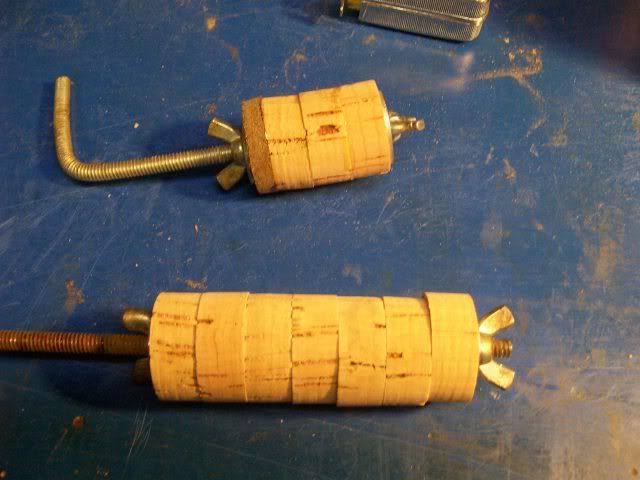

Here we clamped the two up on a threaded rod

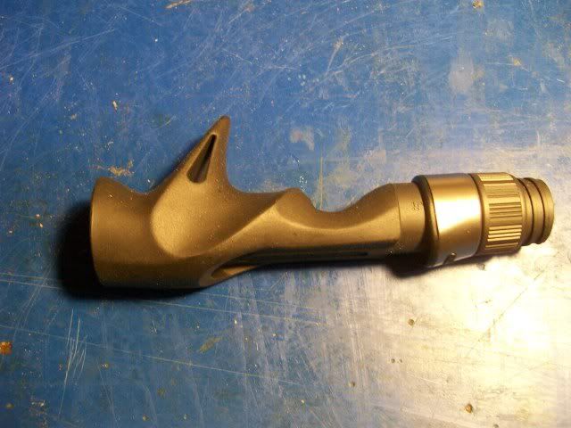

This is the reel seat that was picked out. Fugi exposed reel seat with two finger cuts. He likes these.

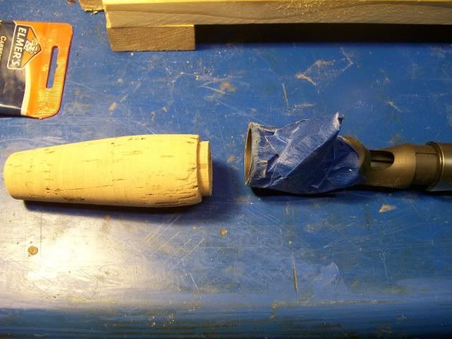

We taped up the seat to prevent dirt, glue, sanding marks,etc

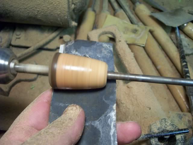

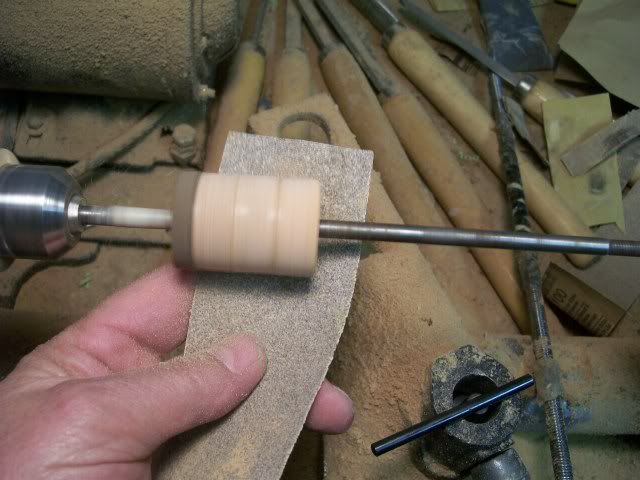

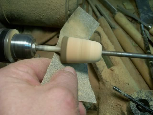

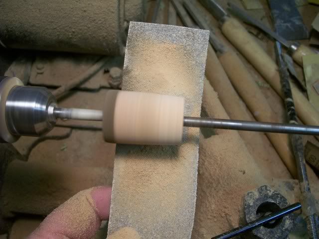

We have here the cork butt going thru it's paces getting sized for the rod. The last pic is my sanding down with 1500 grit-wet sanding. This will make the cork feel silky smooth.

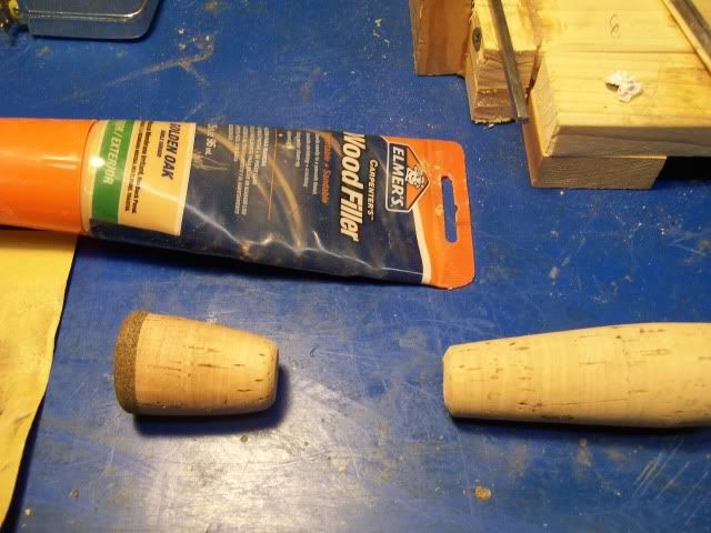

This is the cork peices ready for installment.--almost

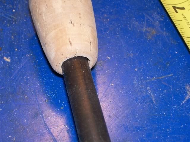

We are cleaning up the butt of the blank to fitting and gluing

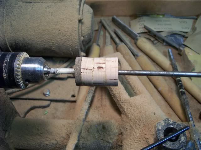

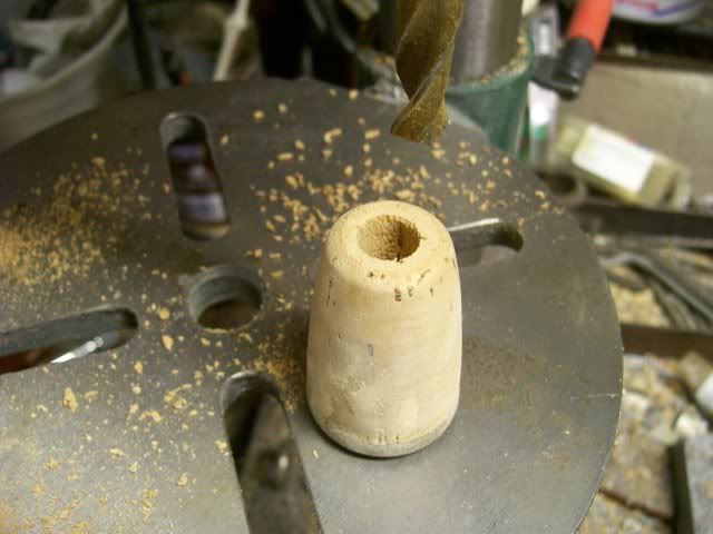

We sized up the butt and found it to be .500--half an inch. The cork is drilled at .250, so will be drilling and cutting.

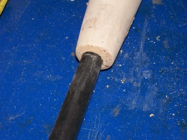

That just had a 7/16" drill bit run thru to open it up. Now what I did was run a dremel tool to open it up more to fit---yea, you don't see that operation. Little hard to do it and take a pic..

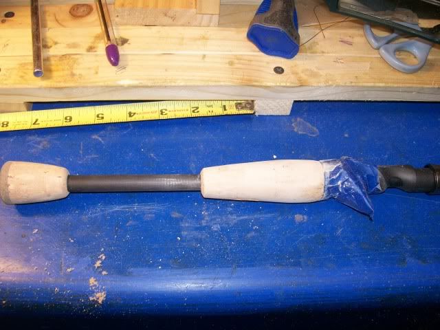

Here it is fitted onto the blank
