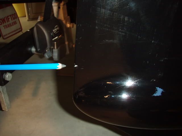

I've noticed that we get alot question's of "How To unblock" your speedo,so i put together a couple of picture on how to to the task.It's very simple once your been shown once....
Step 1:This is done on a Mercury 150,so if you own another brand it might be a little different...
On the lower unit right on the front of the outboard you will see a notch as shown in the picture,this is the blocking occur's,usually by bit's of wood or similar.....
